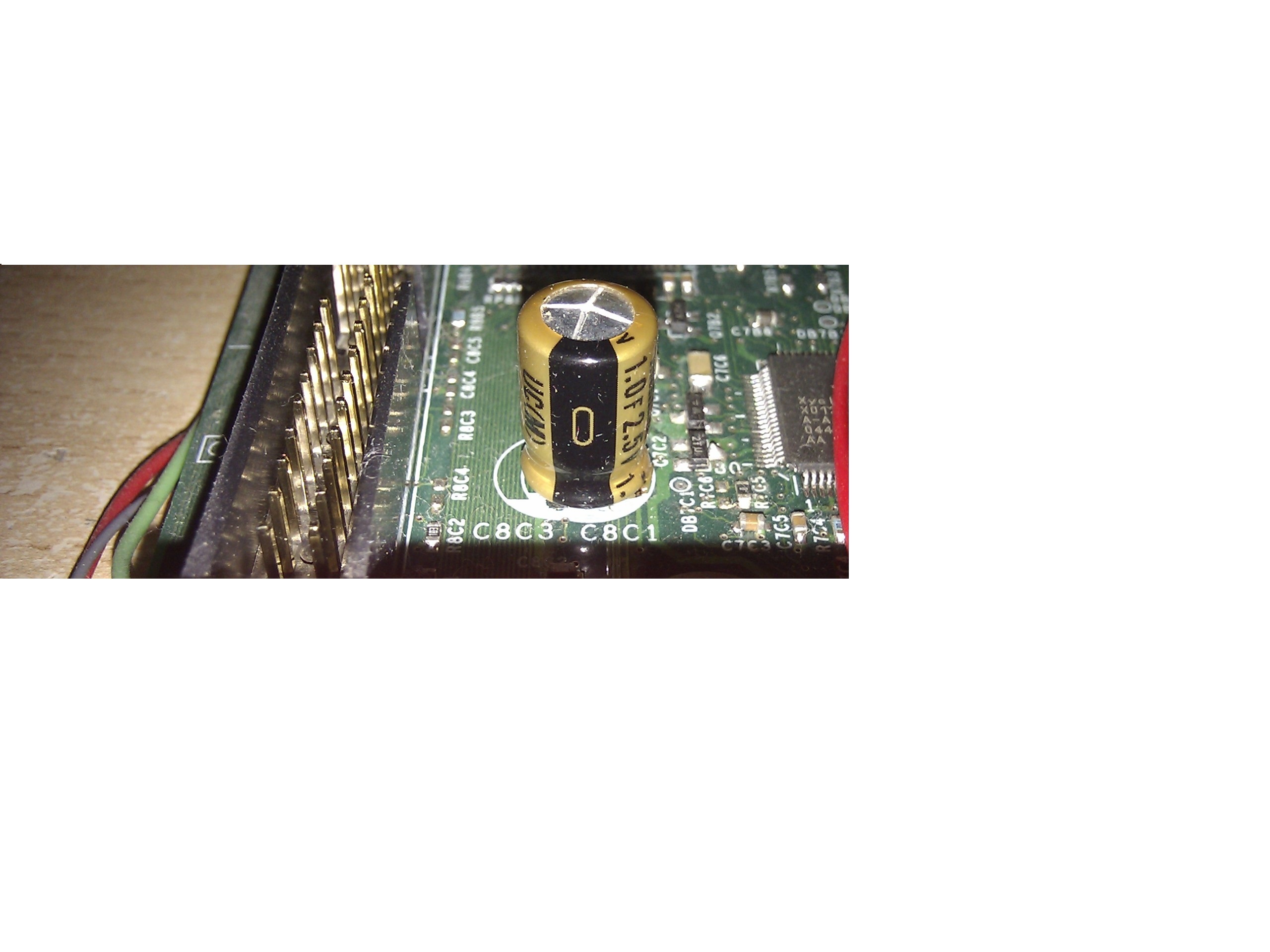

i have a 1.6 motherboard the clock cap is bulging what do i do

I've had a look around the net and if it really is a 1.6 it won't leak as they are different from the aerogel ones in models 1 to 1.5
But if you really want to do something about it you need to replace it as the box won't boot without it .
Have you any photographs of the offending capacitor .

yess i have a picture

It does look a bit bulgy you are right , does anyone else know whether these leak or not ?
If not I would tend to leave it alone and if it fails replace it , I think this is the sort of replacement you need
http://www.active-robots.com/1-0f-2-5v- ... -capacitor
If there is a chance it will leak I would take it out asap :-)

Replace it before it leaks, no point leaving it, it's a 2 second job.

no disrespect rocky buy soldering is hard for me dont have stable hands
i wil trie thanks for the link for the cap

Scroeffie , am am the same as yourself with soldering , probably just don't do enough of it to be confident .
Unless you can find any information of a 1.6 clock capacitor leaking I would leave it alone.
It might stop working at the worst and then you would know to replace the capacitor first but as far as I am aware these ones do not leak .

That looks blown already.

So if it's probably blown and no sign of leaking would it be ok to leave it ?

are 1.6 becoming a problem? probably not as bad as 1-1.5 but they may now be showing the same signs. i will keep an eye out for my 1.6 leaking, or dying.

Yes they are. They are only rated for so many years at so much temp range etc. All xbox Capacitors should be replaced at this age really. Regardless of version.
Yes 1.6 clock cap can fail, yes they can leak. Replace it.

The life of any capacitor should depend on the typical temperatures it has experienced during use and that is largely dependent on the ambient temperature, location ie.ventilation, insulation caused by dust/fluff build up and of course how often it is used.
It is my contention that the clock capacitor only goes as early as some people here have experienced because the Xbox is kept power on ie. off but with power. So it is being kept at its working temperature 24/7 365.
Capacitors are normally rated to 2000hrs at 85 degrees Centigrade and that doubles every 10 degrees Centigrade below.
EDIT 02.03.20
Researching recently in regard to this I've learned that most clock capacitors types/brands used in the Xbox are actually only rated for 1000hrs at 75C. Many of the replacement 1F 2.5v capacitors you can find are only rated to 70C, some even less with a recommended maximum operating temperature of 60C. That significantly affects the calculations made below.
As the Xbox, even a v1.6 rarely exceeds 45 degrees Centigrade (using XBMC reported temperatures) and the CPU/GPU temperature is likely way above the clock capacitor because of where it is on the PCB I'd bet the temperature is nearer 35 degrees Centigrade.
But lets assume worst case that it is 45 degrees Centigrade: that would give it a life expectancy of 32000hrs. Given that most users are not going to be keeping it on 24/7 365 and unlikely to be using it more than 4hrs a day (a gross over-estimation over its entire lifetime) that is 8000 days, about 21 years. Call it 20 years and, in theory if well cared for even a still regularly heavily used Xbox should not expect to suffer clock capacitor failure until the end of next year at the earliest.
In reality you can probably double that to 40 years and for many of us it is unlikely to fail during our lifetime.
The capacitors that are more likely to go are those on the power board which get far hotter in normal use and indeed that is what has happened to me 5 years ago with my most used Xbox (a <10 year old v1.6 2005 Xbox) and why I bought a couple of spare v1.6 ones to cannibalize.
