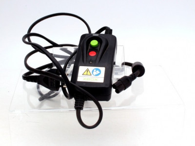

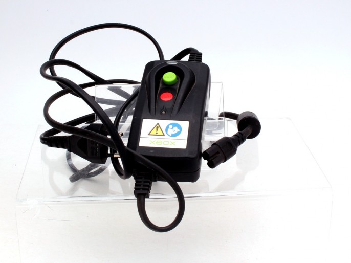

I had the same problem with interferance. When the LED lightbulb was on my Xbox was squealing (I blame the foxconn power supply).
I've ordered the Xbox Protection Cord (X800925-100). I didn't have very high hopes, but to my surprise — it works! No more annoying noise, problem fixed.
Re: RF Interferance.
For any thing to make the xbox psu do that I would replace the led lights with something better as it might damage other things in your house.Lion wrote: ↑Thu Sep 28, 2017 7:12 pm I had the same problem with interferance. When the LED lightbulb was on my Xbox was squealing (I blame the foxconn power supply).
I've ordered the Xbox Protection Cord (X800925-100). I didn't have very high hopes, but to my surprise — it works! No more annoying noise, problem fixed.![]()
