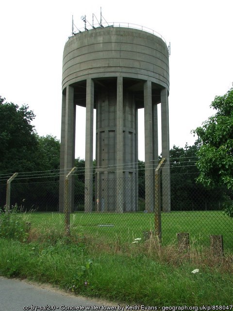

The different ways we get our water is quite interesting, where I live this water tower a few miles away supplies all the surrounding villages.
Then there's a hot water tank upstairs with a big element in it to heat the water. Trouble is the water around here is really hard so we get ridiculous amounts of lime scale which ruins heating elements.
With phase two of the extension we're ripping out most of plumbing and having on demand hot water heaters as they're meant to be more efficient, and hopefully a water softener.
You all wanted to know that didn't you

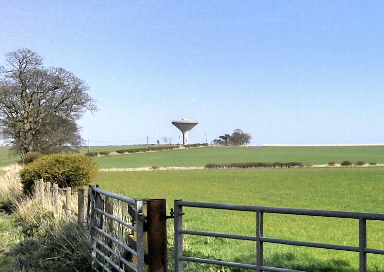

I love those flying saucer oneshawsey wrote:Love this thread xman also here in Northumberland UK on the subject of water tanks , a flying saucer one here not far from home in Bedlington at Morwick
There's an old brick one near me that they're converting into flats, pics here and here if anyone is interested.
Apologies for the slight hijack xman.
