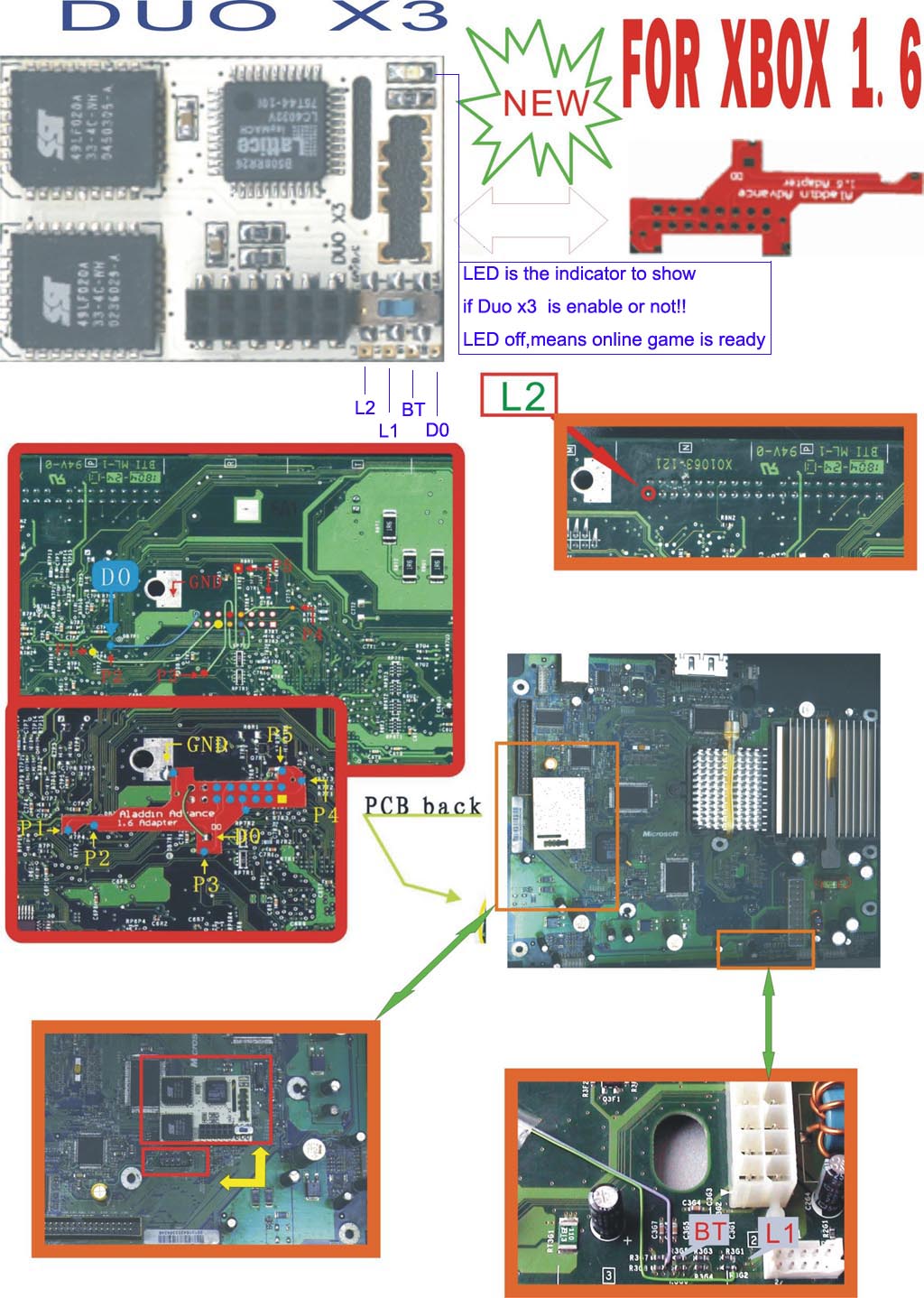

The mod chip used is the DuoX3 (I realize this is not good and one of the cheap knock-off, so that may be a problem).
I am not a complete noob. I know how to FTP and all that. It's the flashing of the BIOS and EEPROM Stuff that confuses me.

I think his using a cheap Chinese chip called an X3 and is more like an Aladdin than an Excuter X3. It is a pig to flash and comes pre flashed with an m8 or m8+ bios, (switch on chip selects 1.0-1.5 OR 1.6). It has nothing in common with "THE X3" we know having only 2 x 256k bioses on board. It does work straight away with Slayers so it boots to EvoxDash by default. I just use Slayers to set the default link to XBMC and your away. I have a number of these chips if they are the same I think your talking about, (X3 Logo on the bios flash screen?)
