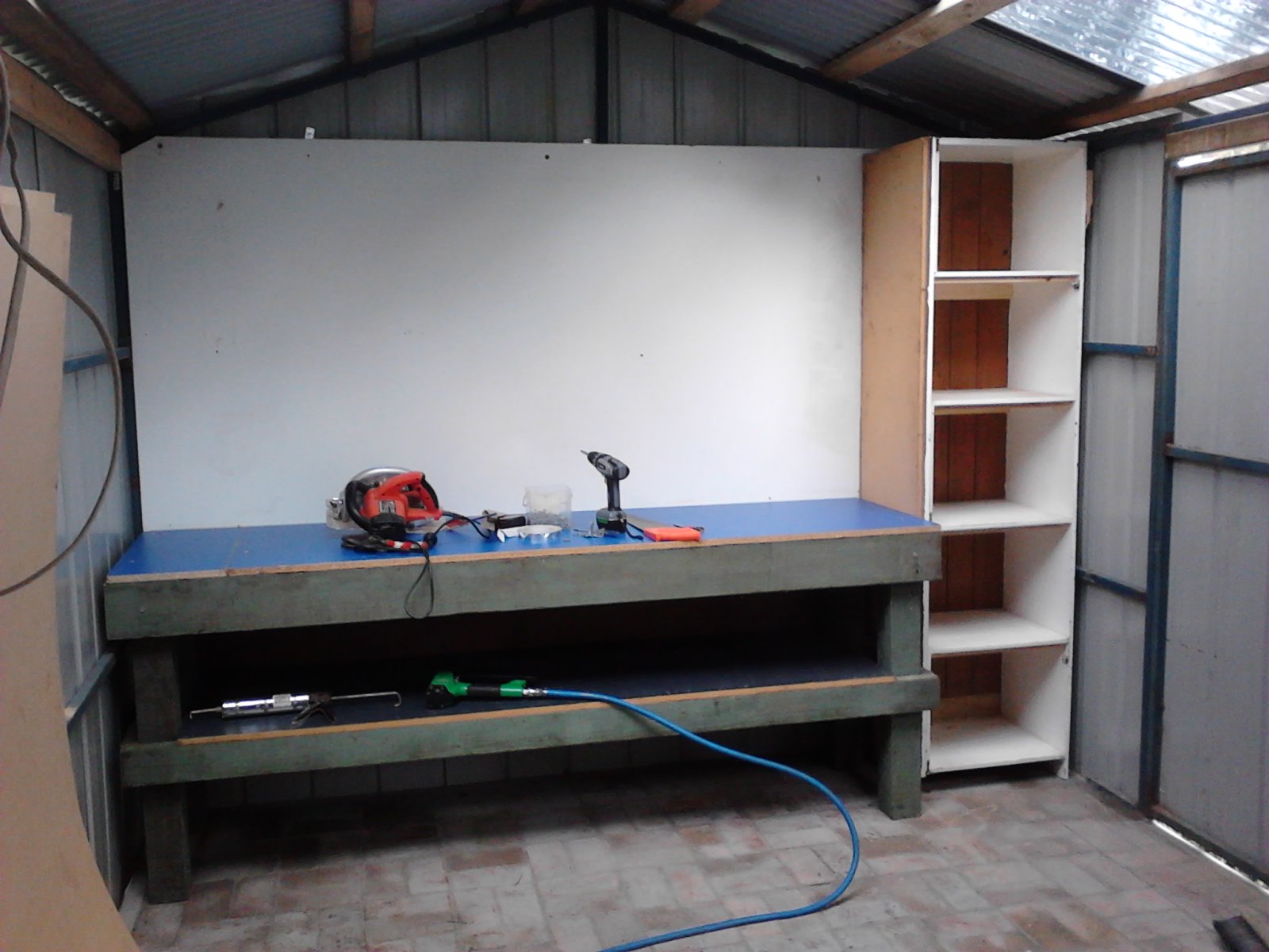

The cable i have is no longer sold by the seller, xman has 7 but you'll freak when you see my collection . I'm in the middle of setting up a workshop with a dedicated clean area set aside for xbox mods.
This is my clean area work bench, still to build another bench and some shelving for my other stuff.
