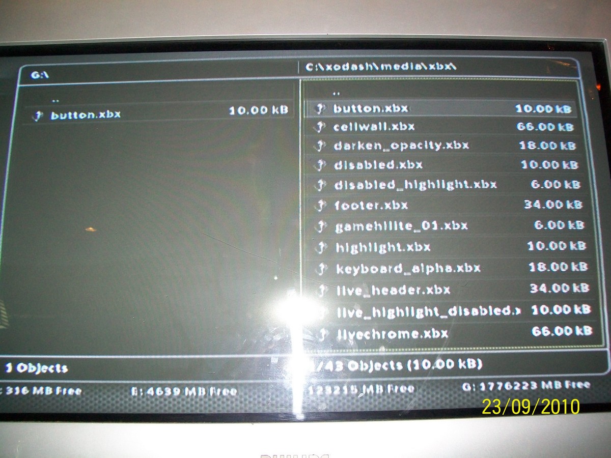

after 3+ moths playing with 2 tb xbox games coinops etc yesterday my coinops did not work anymore
wierd symbols when i ftp and loosing data coruption i think
but i did format 64k clustert with xb 1.3 so now i need to format again but how can i prevent this from hapening again ??

both f and g are when i upload a test file to part f: or g: its 65k difrencs is this correct ??
after and if it’s 64 + bytes the hard drive partitions are correctly formatted with 64k Cluster Sizes
517.632-452.096=65.536 << cluster size
Re: XBOX 2TB SATA Upgrade Tutorial
This is the file I always use to see if it takes up either 32 or 64k..........

i did the math followed the guide from a to z i hope now nothing gets corrupt it was around 250+gb than file started to get corupted wierd symbols etc
but now i no i did it 100% correct
this is what i got after ftp a file tested both f and g
