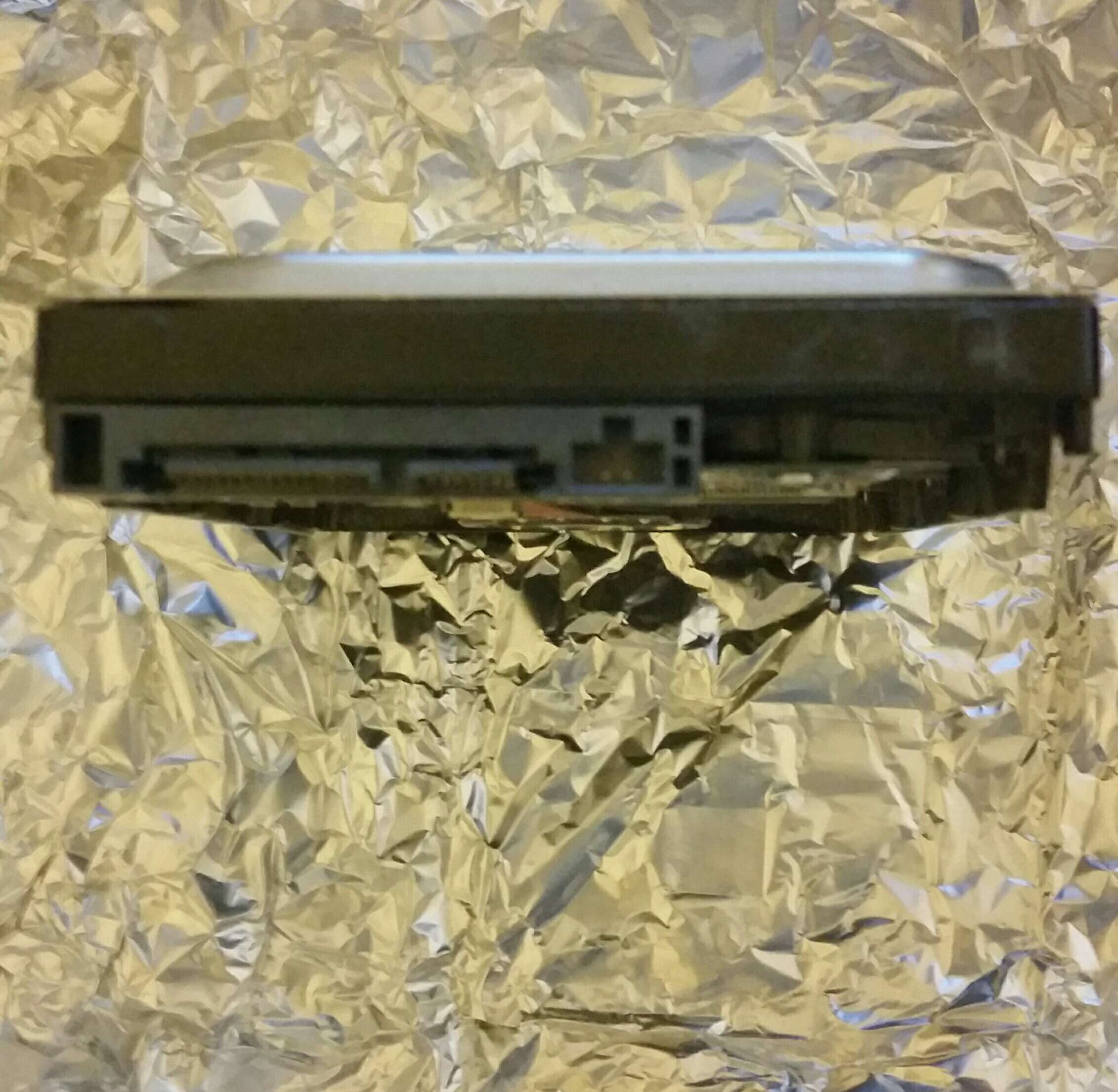

Re: XBOX 2TB SATA Upgrade Tutorial
Hello everyone, I'm new to xbox modding.
It's my first time upgrading the HDD as well.
I've been meaning to ask you guys if my hdd is supporte(see attachment), and will this adapter(kingwin):https://www.amazon.com/gp/aw/d/B002SZDO ... 8FN94BPA9M
work with my hdd? Sorry I'm new to all this, it'll be really easier if I had an ID hdd.
