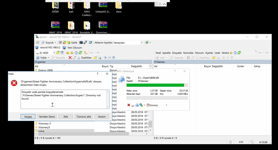

I read that guide and i tried to connect 2 Tb and 1TB hdd to my Xbox. I can see F and G partitions. But I cant upload more than 130 Folders and 260 GB by using FTP. And ıt shows error " director dont find" then It stops uploading. I Used xpartition 1.1 and 1.3 as told in F and G guides. I tried to do as 32/64 cluster but I couldnt upload more games.
Is it possible to remove theese limits? I tried all of bios in device ( 5032-5035 ind and evox)

Sounds like its not formatted correctly to me .
It must be 64k clusters , re read the tutorial , make sure this is right :-)

Download this & copy it to your hdd, now load it up select fatx & after chimp loads, pick Option 3 > Option 1 & this will tell you the cluster sizes or if there are any errors.
Download Chimp 261812
Also since you have nothing to lose, you can format the extra partitions using Option 3 > Option 2 > pick what one you want.

I finally managed
thank you so much
