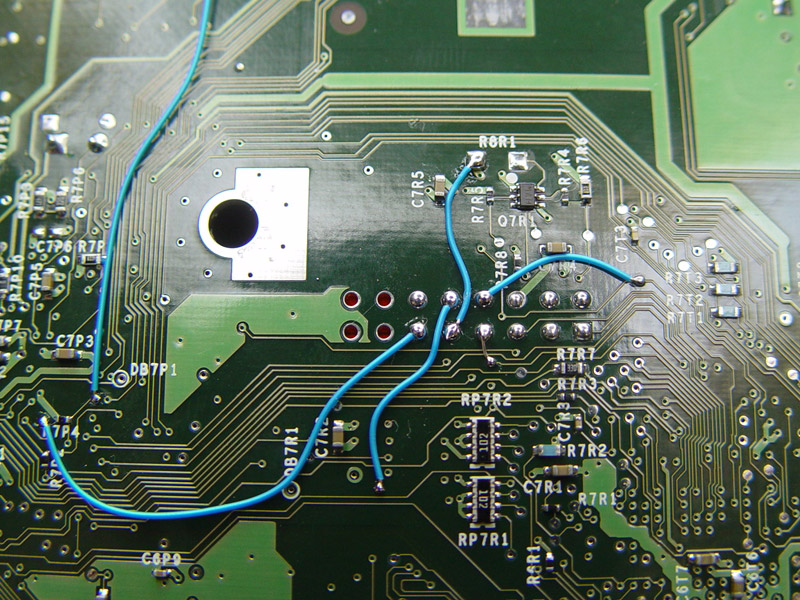

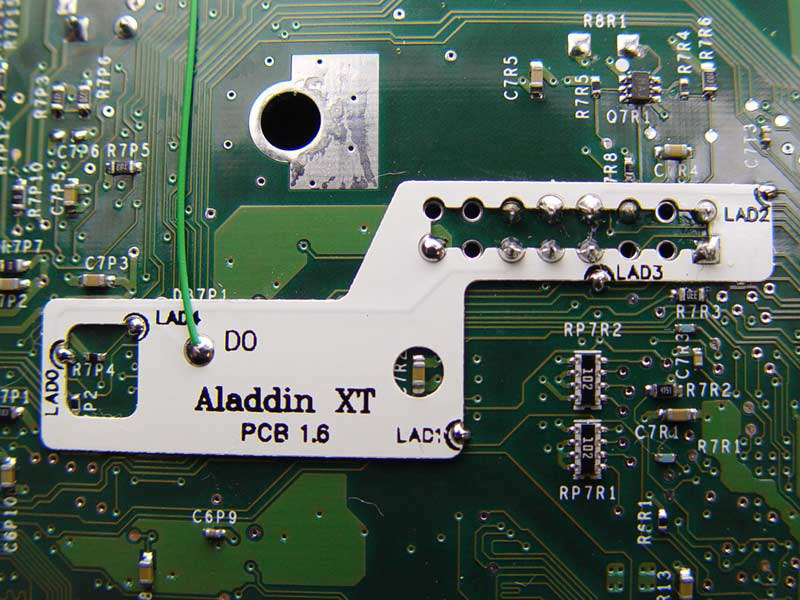

Found some 1.6 install Pics that may help. I don`t know how hard
it is to find pcb`s but the wire install here looks clear enough.
Goodluck!

You have to connect the D0 point, that tells the Xbox to boot from the LPC bus.
(You only need to ground the D0 point since you won't be booting the retail bios as its not needed.)
http://www.xbox-scene.com/articles/preparing-d0.php
