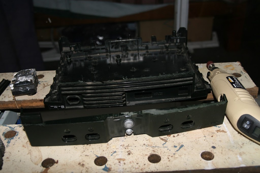

You can use a sharp hacksaw blade, a craft / stanley knife or a large Bowie if your name is Rambo. A dremel is best or if you are a cheap bastard like me a cheap dremel knockoff does just as good for 1/3 the price - see my weapon of choice to the right of pic.

After cleaning up the cuts with a fine file and or sandpaper its time to trim the tin shielding, i should have noted the my first post that we are aiming to cut the case down by approx. 10-12mm - rough cut 10mm allowing a few mm to clean up.
Now get your shielding and at the front where the dvd tray was there is a recess in the tin, mark across from this line and then right around all sides.
Now with tin snips cut along your marked line all around.
Cutting all done and ready to clean up the edges.
Ok so now we have the base completed i have placed the lid to show how much we need to cut the lid down by.
Easiest way to start on the lid is to mark a line 10mm up from the bottom of each side and cut straight across, when looked side on you'll notice how the side curve up from the middle to the outer edges. Once the 10mm is removed sit the lid in place and notice where the curves are so you can mark for the the next trim.
