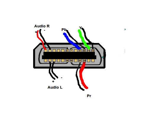

If you want to build your cable this is the pinout.
The conector is seen from the front with the cable in the back.
(dont forget to solder pin 6 to 18 and pin 7 to 19)

So keeping with that diagram, is there a way to have the original Composite A/V and have the Component attached (so you can enable HD mode)?

How in the name of HELLLLLL do i get the Shield off of the connector!!?? Im poking around and its fucking impossible!

the shield or the rubber protection? i used a flat screwdriver.

I meant the Metal sheild. I did the component mod to the composite cable and i cant get audio in NTSC Stereo (composite) Or Component (YPrPb) mode. Im looking into the issue.
