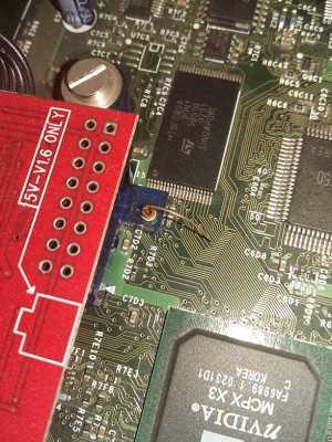

I've opened the case and the mod chip appears to be xecutor 2.6 Has a red board with a big white arrow pointing "edge of the case". I lifted it out of the pins and underneath was printed "X2.6". It has a blue led which comes on the board when powered on. There is a slight flex on the mainboard right next to pins 1 and 2 so not entirely sure if it is enough to break a connection, but front dip switches come up a yellowish green which I think it means ok? Otherwise they would turn red?

Posts: 974
Re: Hard modded xbox only boots to stock dash
The D0 wire has dislodged, put it back in its hole and the chip will boot.

Hi, I will look into that D0 wire. I've been trying to find install instructions for this chip. I've opened it up again and the pin array can be lifted straight out of the socket. Shouldn't it be soldered on? I tried holding the pins down to the board while powering on but still doing same. Should I lift out the mainboard and check underneath?

Thanks guys,
It was exactly the D0 wire which had come loose. It must have popped out in transit. It's the looped wire in the photo I posted. My eyesight is going so took me a little while to get in the hole :lol:
I also removed the clock capacitor,there had been some leakage around it. I got it off and cleaned around it. Put everything back in place and powered on and it booted into xbmc :D
