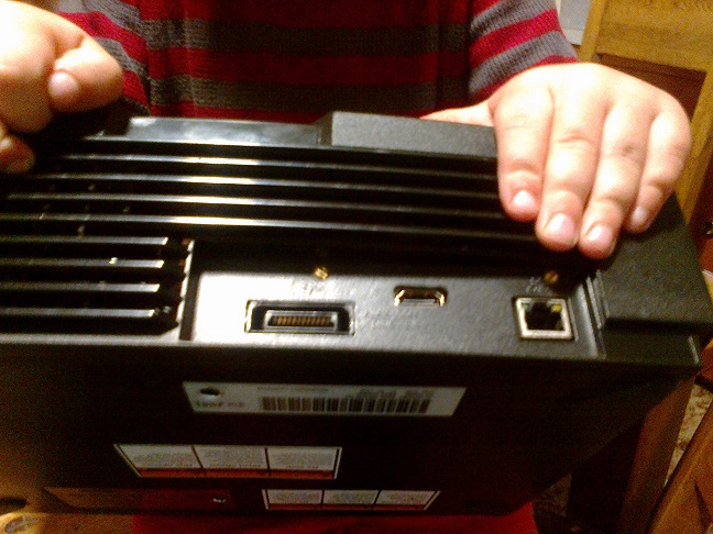

The next machine I needed to mod was the wife's machine, a 1.6 so didn't take long to have to work out how to get this done. Even though I did get this 1.6 HDMI modded, I don't think I will go out of my way to do another 1.6. The earlier machines make for an easier mod I believe only because not having that post hole in such a convenient spot of the board right near the AVIP connector that most of the wires need to go to. I really hate having wires going around the side of the mother board so that wasn't an alternative for me so I had to find holes for the wires to go through the 1.6 board.
I found a hole over near the DVDrive power connector, (not exactly real close to where I needed it but better than going around the side of the board). Only a small hole but I was able to get the 3 video wires and the 5vDC wire through it. This picture shows the 5vDC coming from the DVD power connector. That did not work. Not enough current so I had to run that wire down the board to the mother board power connector like the earlier board. I also found two single holes through the board near the crystal a lot closer to the AVIP connector that I was able to get the audio wires through.
This machine I used Velcro rather than glue to hold the converter box in place. I also drilled a hole through the base of the converter box to go over the heatsink board mounting pin so I could use the pin as a locator. It also enabled the box to sit flat. You can see the Velcro on the top of the two chips and the other side of the Velcro on the base of the converter box. Although the glue was good, Velcro enables me to remove the box if need be.
Here is the base of the converter box held in place with the Velcro and located on the heatsink mount pin.
Board in the base and wires routed and soldered in place. The 2nd picture clearly shows the earth wire soldered to the earth ring around the upper left mount hole and the holes I used to run the audio wires through near the crystal.
The lid clipped back on after filing a slot out of the lid's edge for the wires to go into the converter box.
HDMI case mount cable plugged in the converter box and bolted into the Xbox case.
Done, ready to start using HDMI cables instead of Xbox component lead sets. ;)
