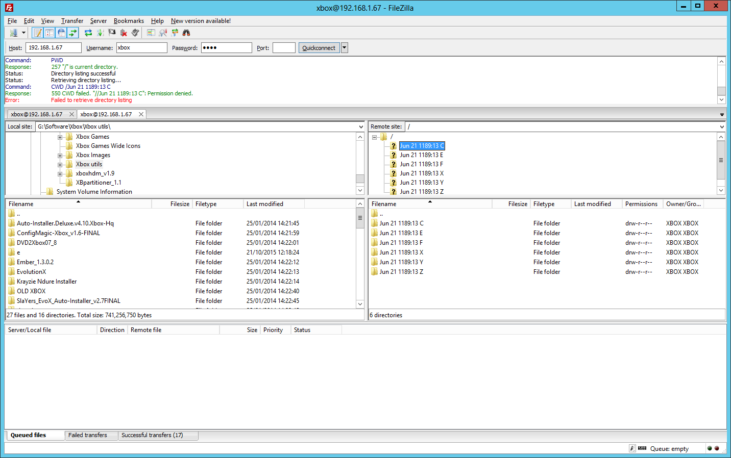

I need some help. I have previously softmodded with SID 5.1,
I used the extra's disc to update the softmod and access ISO, this all works great but...
My problem is that when I upgraded I do not get the updated version of XBMC 3.5.3 as my dash. I can locate and run the XBE file of 3.5.3 but cannot get it to run as my current dash. I keep getting the original version of XBMC from the original softmod from the SID disc. I have copied it to drive C, drive E, in the DASH folder, DASHBOARD folder still boots old version.
Please help
Posts: 974
Re: Softmod Tool: Need testers.
arzy wrote:I need some help. I have previously softmodded with SID 5.1,
Please help
Can you upload a couple images of your C & E partition please.
Just to note, the only thing in C should be a folder called Dashboard.
Also what version are you running? 2014 or 2016 RC3?
arzy

Thought I would update an old Splinter Cell mod... went through the menue and installed the 2016 mod...
But after its done I cant get any FTP access... it states that its enabled but filezilla will connect but wont access files? it seems to add text to the file setup as well? instead of C,E,F etc I get "Jun 21 1189:13 C" for example... :?
Posts: 974
You have three options.
1) type the drive letter into the remote site bar, ie C, E, F or G eg....
2) use another FTP program, FlashFXP or other free FTP programs work fine.
3) install build 570 of UnleashX as that's the last dash version before issues started.
(I use the latest version because of its skinning engine updates, if you use an older build the skin won't have all information or labels)
Note:
It's only FileZilla that does this & it doesn't always happen, I can go months without issues & then it starts.
