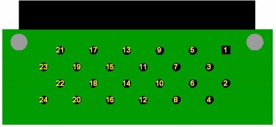

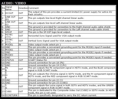

I have a few HD/component cables(only anloug audio,Red/white) for the Xbox,and was wondering if anybody hsa wired a SPIDF out. Was thinkinking I could just unsolder say the red and resolder on correct pin for digital audio. Or would I be better off just wiring a plug right off the MoBO.I'd perfer the first cause I'd like to do this to 3 or 4 of the cables I have.
Re: Wiring a SPDIF
Should be a snack if you know what your doing along with these two pics to help........
You may need to have a link soldered in so the chip know what sound signal to output. Not real sure about sound but with video a link is required to enable the correct video you need. See how you go and if you have issues, I look a little deeper.

You will find some usefull data on this topic "Xbox Component Cable": http://www.xbmc4xbox.org.uk/forum/viewt ... SPDIF#p609
with links to: http://www.gamesx.com/avpinouts/xbox.htm
and: http://www.bigmech.com/misc/xbox_ntsc2comp/
