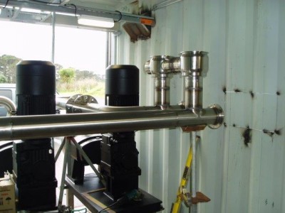

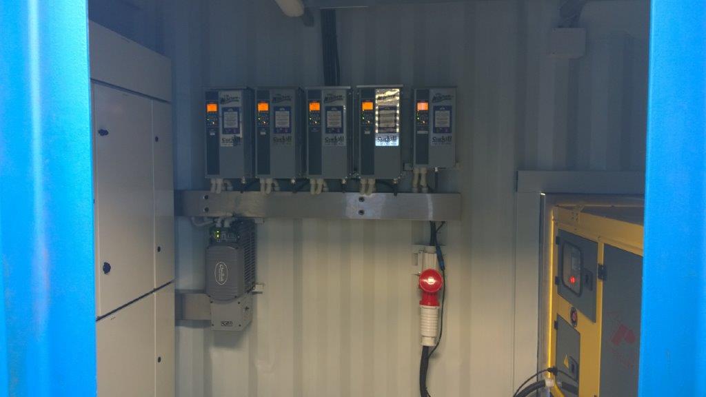

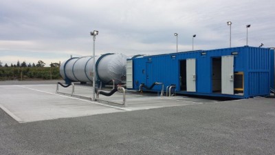

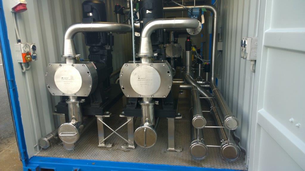

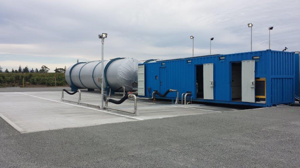

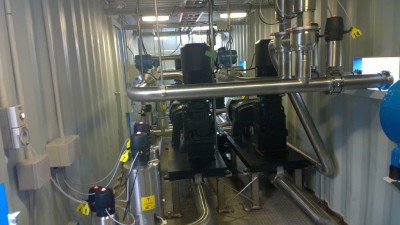

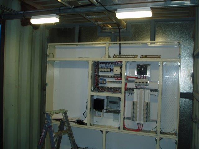

This is something I have been working on it has been 1 year in the planning and development and a concept then this.
Basically it is a portable milk transfer station to transfer milk from tankers to contractor truck's that are not allowed to drive on side roads.
it is handy in the fact 3 tanker loads fit in one transport truck and it saves thousands of dollars driving small trucks back and forward between dairy plants.

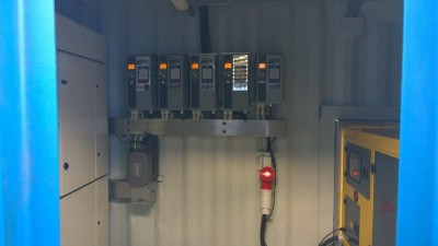

It automatically starts stops changes valves automatically starts the generator etc it is all solar backed up with panels on the roof and as it has no fixed amenities you can just drop it on a concrete pad anywhere and be up and going with out council consent and building plans as you just load it on a truck and away you go to the next location.
The system prints out dockets on a label printer and does a nifty QR code and as it does it captures info on the milk and silo at the same time so when they turn up at Fonterra they just scan the barcode and they have all the info loaded into their plant with no hands .
The unload drivers just type in how much they want and press the go button and it fills their truck and automatically slows down when getting fill.
The system used a special control principal to gently pump the milk sensing if there is cavitation or possible damage to the milk and adjusts its speed to suit, if a truck turns up when a tanker is unloading it automatically stops and diverts milk direct to the loading truck to avoid double handling the milk reducing milk solid damage also.

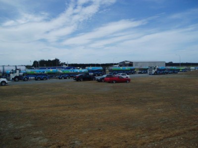

use today there is currently 24 tankers lined up and around the corner and up the highway waiting to be emptied
