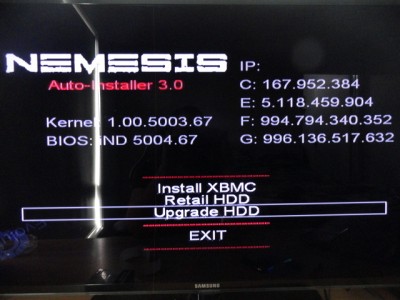

I finally found some time to install the above 2Tb Seagate drive and adapter I bought...
iND-BIOS 5004.67 was used and prepared the drive with my auto-installer...
XBP1.3 was then used to reformat F & G individually to 927Gb at 64 cluster...
The entire process took about 10 minutes and seems to be working just fine...

Did the cluster test on G partition while in evoxdash:Xphazer wrote:Always manually check your clusters size. This can avoid you some massive headaches.
before: 996.136.517.632 bytes
after: 996.136.452.096 bytes
difference of: 65.536 bytes
conclusion: 64kb cluster size confirmed
Cheers
