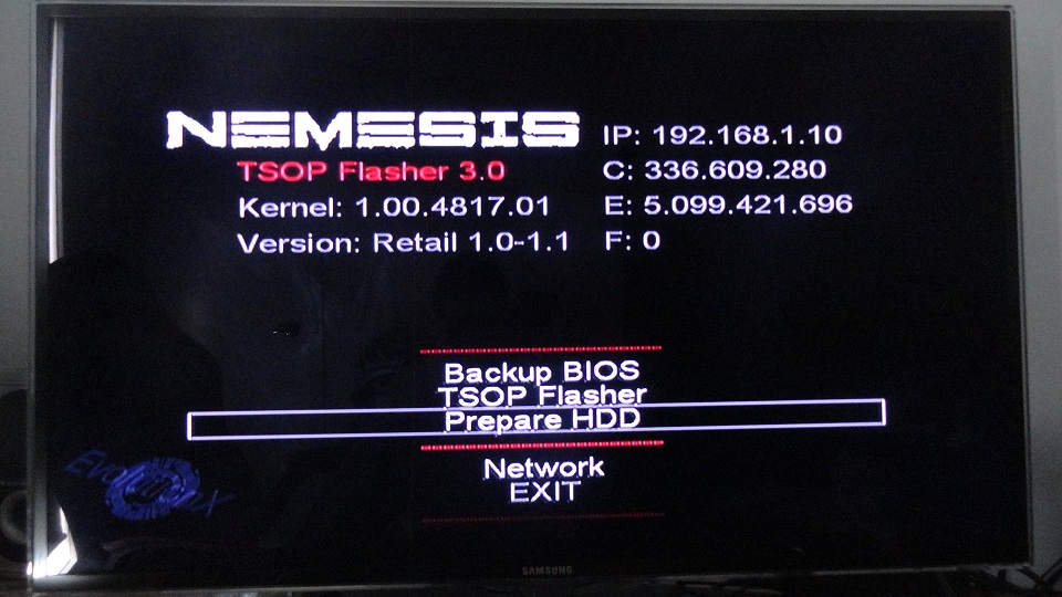

Re: NeMesiS TSOP Flasher & Auto Installer 3.0
NMS TSOP Flasher 3.0 GUI using EvoX
1) TSOP Flasher:
#non Winbond
#Winbond only
2) Prepare HDD
3) Networking
4) EXIT
#XBMC
#EvoX
#MSdash
#Reboot
#Shutdown

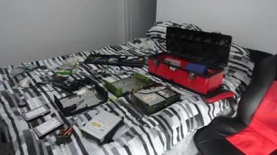

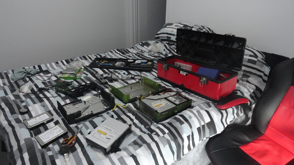

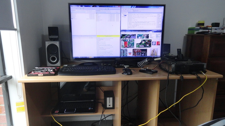

Ive been busy last couple of days but its time to get stuck back into it... I managed to find an old xbox on ebay for $20 and the guy happened to be a few houses up from me, love it when things work out so perfectly... He wasnt sure of the state of the console but I got it home booted no problems and the Xecuter logo was on confirming it was modded. It obviously was just purely for playing pirated games as it only had the original dashboard. Cracked it open, version 1.1 with samsung drive and some crappy generic single boot modchip with SST chip... I quickly replaced it with an "Aladdin Advance" (also with SST chip) I had laying around giving me duel boot, the orignal BIOS (TSOP) or the modded BIOS (Modchip)...

NMS TSOP Flasher 3.0 (exploit) GUI
Again Ive been using "Evo-X" as the Graphical User Interface...
I've had to remove "Version Detector" & "BIOS Checker" apps as they would not load with retail BIOS/Kernel but I was able to incorporate it within "Evo-X" by determining the xbox version based on the retail kernal version and the retail BIOS MD5 algorithm... I aquired MD5's by downloading all known retail BIOSs, using EBtool to retrieve the MD5 and cross referencing some from "BIOS Checker v50" bioses.ini...
